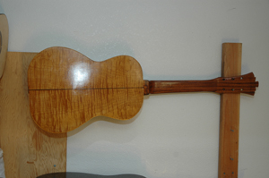

One thing that has improved my atempts at finishing with KTM-9 is using a little bit of akaline dye. I didn't really like the way it looked clear. But have tried a couple of color combinations, which although I haven't buffed them out they look pretty good to me.
Thats the raw maple underneath and the honey-mustard color I ended up with
PostPosted: Fri Jun 09, 2006 12:07 pm
Posts: 2951
Last Name: Beaver
City: Lake Forest
Yeah, I use a little amber color also. That way it loses the blues...
